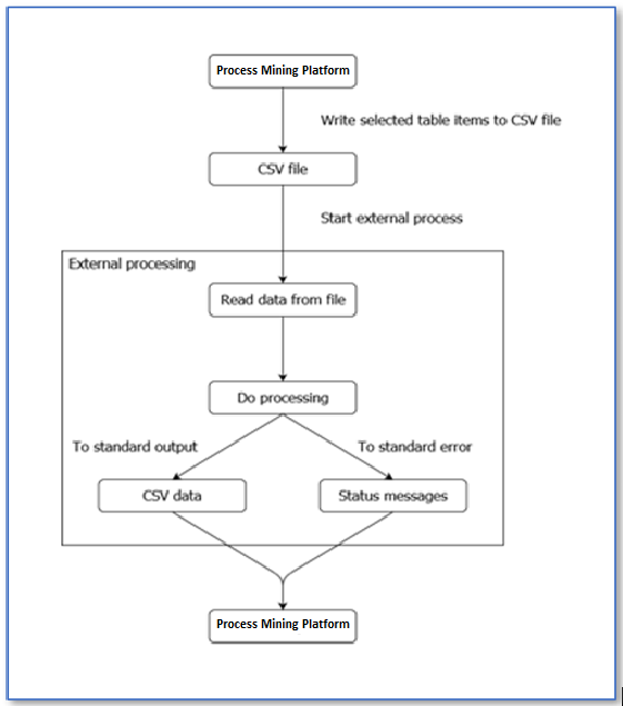

Processing data with external tools
When the datasource is reloaded, the UiPath Process Mining platform will output the defined attributes into a file. The platform then executes the external process with the arguments supplied by the developer.
The external process should do its processing by reading the data from the file and writing the result to standard-output channel. The external process can show messages such as progress indications, warnings, and/or errors by writing to its standard-error channel.
The data on the standard-output channel of the external process is interpreted by the UiPath Process Mining platform as a semi-colon separated and double-quote-quoted data.
See illustration below for an overview of the data flow from the UiPath Process Mining platform to the external process, and back again.

The interface between UiPath Process Mining and any external process accessed through the generic script datasource is defined as described below.
StepDescription
1UiPath Process Mining creates a file containing the data specified by the inputData parameter.
2The external process:
• reads the data from the file;
• performs its processing;
• writes the result to its standard-output channel in a semi-colon separated and double-quote-quoted format.
The first line of output should be a header specifying column names. For example:
"Case_ID"; "Amount"
'110553"; "73650"
'110565"; "14420"
'110689"; "262370"
'110754"; "3500"
'110939"; "50270"
'111155"; "2400"
'111251"; "27530"
'111251"; "27530"
'111397"; "123450"
'111418"; "100"
3The external process writes any status messages to its standard-error channel.
4The external process exits with either a status code of zero, indicating success, or a non-zero status code, indicating failure.
5UiPath Process Mining evaluates the status code returned by the external process
If the status code is:
• zero, the platform will parse the external process’s standard-output channel as semi-colon separated and double-quote-quoted data.
• non-zero, the platform will display an error message, including any messages written to the standard-error channel by the external process. The table load is aborted.
