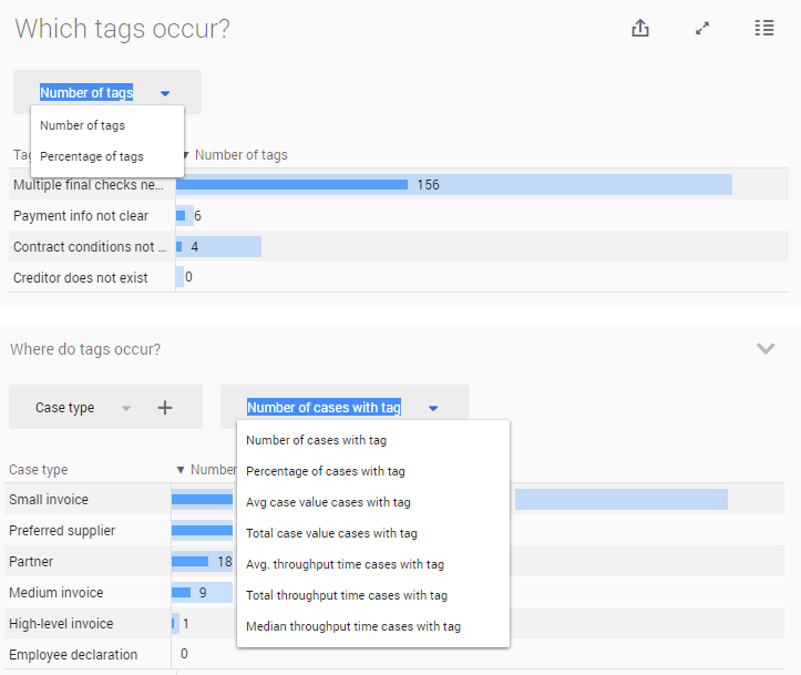

Which tags occur?
You can create various different contexts by selecting different groupings from the drop-down list. The metric selector enables you to select different metrics. See the illustration below.
Below is a description of the metrics that can be used to analyze the cases regarding tags.
Metric
Description
Number of cases with tag
The number of cases that have a tag assigned.
Percentage of cases with tag
The percentage of cases that have a tag assigned related to the number of cases.
Avg case value cases with tag
The average value of the cases that have a tag assigned.
Total case value cases with tag
The total value of all cases that have a tag assigned.
Avg throughput time cases with tag
The average throughput time of the cases that have a tag assigned.
Total throughput time cases with tag
The total throughput time of the cases that have a tag assigned.
Median throughput time cases with tag
The median throughput time of the cases that have a tag assigned.
