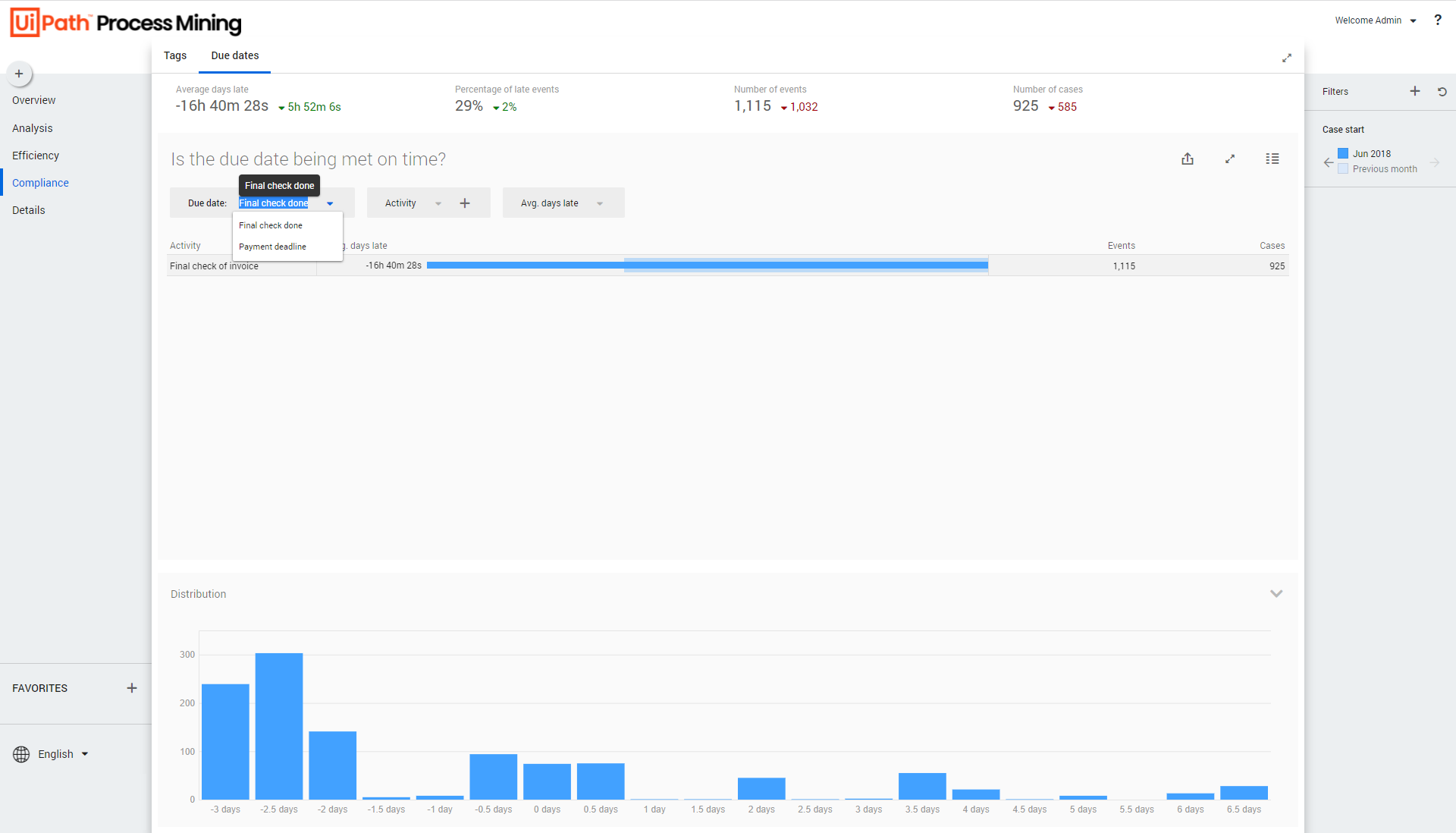

Is the due date being met on time?
Below is a description of the metrics that can be selected in the Is the due date being met on time? dashboard item. See the illustration below.
Below is a description of the metrics.
Metric
Description
Avg. days late
The average number of days that it took to complete events after the expected end date.
Percentage late
The percentage of events that were completed after the expected end date within the selected period.
Distribution
The Distribution chart enables you to analyze the frequency of due dates based on the number of days late. See the illustration below.
