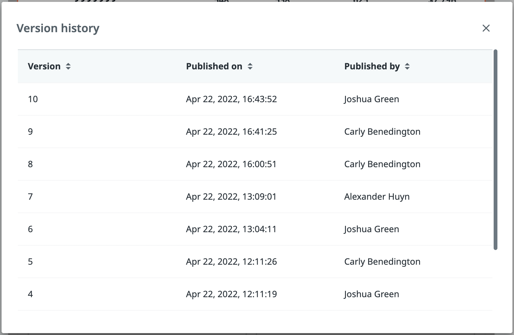

Follow this step to view the publishing history of a process app.
A popup window is displayed with a list of all created versions. For each version, the publishing date, and the name of the developer who published the version is displayed. See the illustration below for an example.
You can also view the publishing history from the Published process apps in the Process Mining portal.
Select on the app card of the app for which you want to view the publishing history and select Version history from the context menu.
