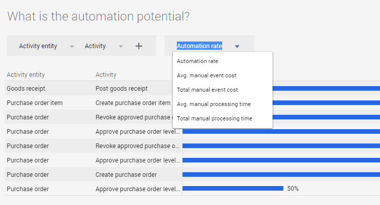

The dashboard Efficiency – Automation can be used to find automation opportunities in the process. For the selected category, the Automation rate is displayed for the current period. See the illustration below.
1917
Note:
The Automation rate is calculated from the events for which the Automated field is set to true. See Input tables of Purchase-to-Pay Discovery Accelerator: Events_base table

The process graph provides a visual representation of event costs related to the number of cases in the process. When hovering over an activity, the metrics are displayed in the hint. See the illustration below.
503
When hovering over an edge, the number of items and the number of purchase orders are displayed in the hint. See illustration below.
540
