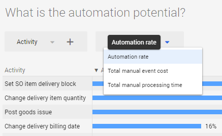

Metrics
Instead of the Automation rate, you can select the Manual event cost, or the Manual processing time as the main metric to be displayed on the dashboard. See illustration below.

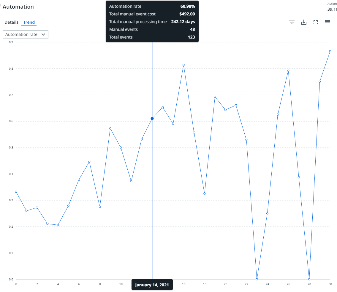

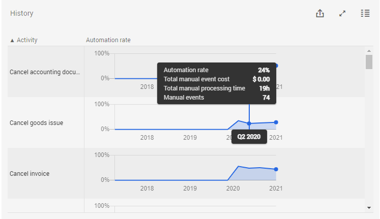

History graph
The History graph shows the metric values for the selected attribute over time. See illustration below.
Below is a description of the different metrics.
Metric
Description
Automation rate
Percentage of events that is automated.
Total manual event cost
The total costs of executing the events that are not automated.
Total manual processing time
The total amount of time actually spent working for the events that are not automated.
Manual events
The total number of manual events.

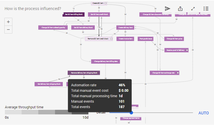

Process graph

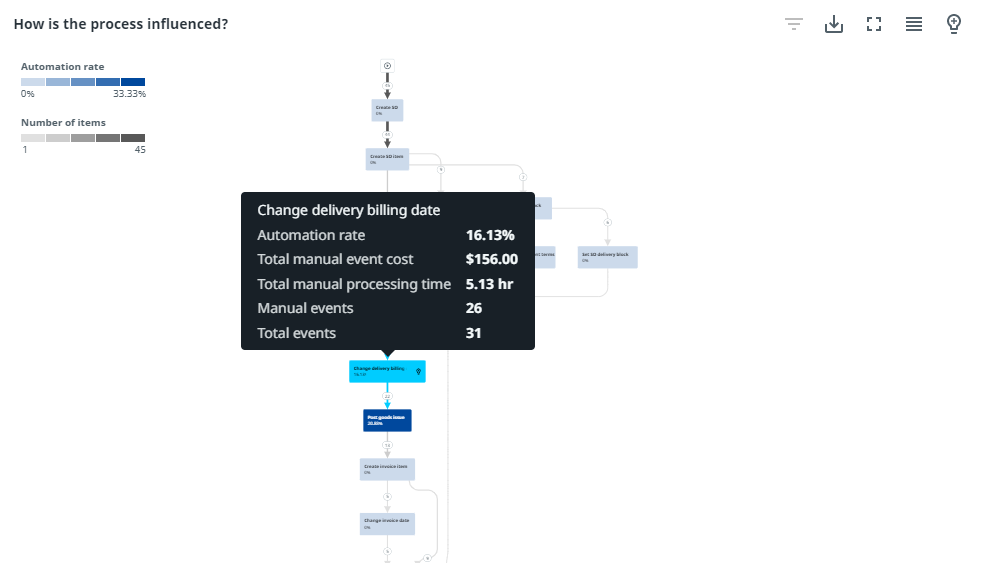

The process graph provides a visual representation of event costs related to the number of cases in the process. When hovering over an activity, next to the metrics are displayed in the hint. See illustration below.

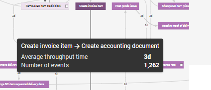

When hovering over an edge, the average throughput time and the number of events are displayed in the hint. See illustration below.

The colors of the activities in the process correspond to the percentage of automated events for each activity. See illustration below.
