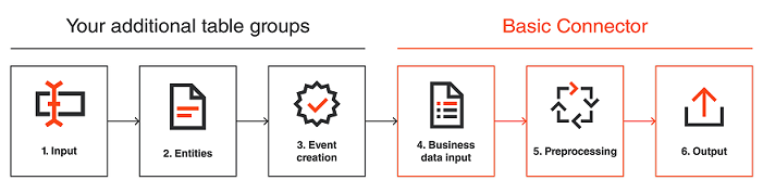

When developing your own connector, it is recommended to not completely start from scratch but to use the Basic Connector as a template. Following the structure of the Basic Connector ensures that the created event log fits the format required by AppOne.
You can extend the Basic Connector to match your source data by adding additional table groups to the Basic Connector. See the illustration below for a recommended structure of your Connector.
Connector framework
Hover over the image and click to go to the related page in the documentation.
1. Input 2. Entities 3. Event creation 4. Business data input 5. Preprocessing 6. Output
Below is a description of the different table groups of the Connector.
Table group
Description
1. Input
Load your input data into the Connector.
2. Entities
Calculate the entities of your process.
3. Event creation
Calculate the events relevant for your process.
Load the input data for tags, due dates, and reference models.
5. Preprocessing
Enhance the data and add business value.
6. Output
The final data that will be exported and loaded into AppOne.
