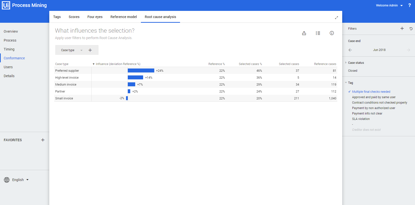

To perform a root cause analysis first define what you want to analyze. Then add user filters to define the Selected cases for the analysis. See animation below for an example root cause analysis based on tag Multiple finale checks done.
In the above example, 22% of the Reference cases have the Tag Multiple finale checks done. Cases that show a large deviation from the Reference % of 22% indicate a possible high influence. In the example, 46% of the cases with Case type Preferred supplier have the Tag Multiple finale checks done. This deviation of +24% indicates a possible influence and you may want to analyze these type of cases to prevent the occurrence of this tag in the future.
