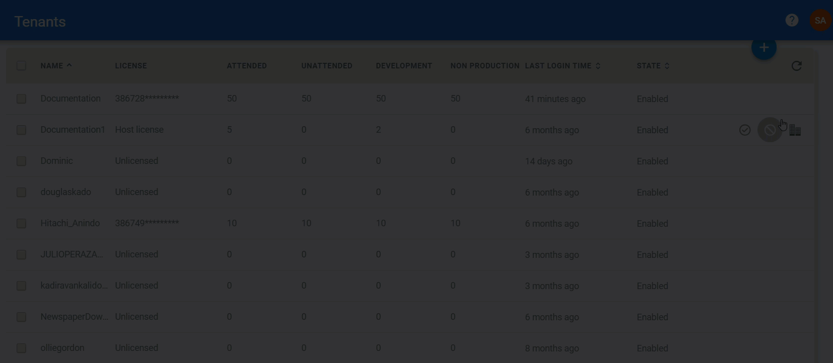

From the Tenants page
- In the Tenants page, click the Allocate Licenses button for a tenant. The Allocate Licenses page is displayed. If the tenant is licensed you must first proceed to remove the existing license before starting to allocate new ones.
- At the end of each row you can see the number of available licenses and their total number at host level. Allocate licenses as you wish, but keep in mind that you can not exceed the maximum per category.
- In the below screenshot, we allocated 2 licenses for Attended Robots, meaning that 1 out of 10 licenses was still available.
- Click Allocate. Note that the Tenants page has been updated according to your changes. Take into account that the Allocate button is only enabled if you make some changes.

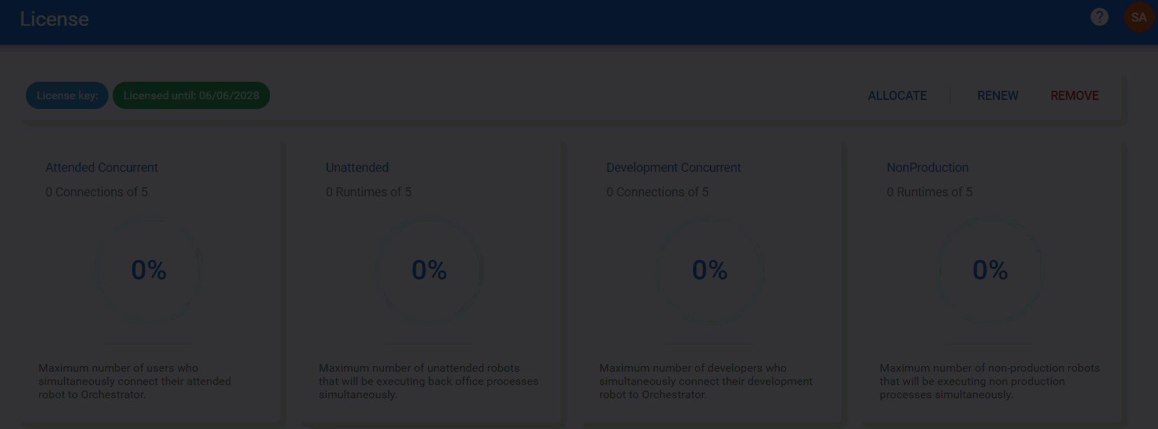

From the License page
At Tenant Level
- In the License page, click Remove. A dialog box is displayed, asking if you are sure you want to perform this action.
- Click Yes. Your license is deleted. Note the License page is updated and your tenant is displayed as Unlicensed.
