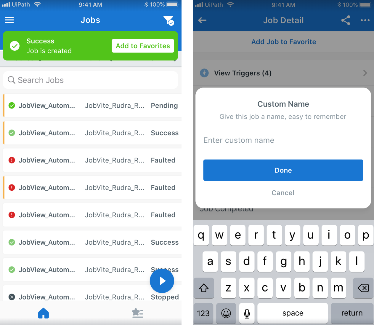

The Job Detail page is the primary location where you can mark a job as a favorite. To mark a job as favorite, follow these steps:
  1. In the Job Detail page, click Add Job to Favorite. A pop-up window is displayed, allowing you to give a custom name to the selected job.
  1. In the pop-up window, enter a name that is easy to remember. You can enter up to 25 alphanumeric characters.
  2. Click Done. The job is marked as favorite with a FavoriteStarFilledFavoriteStarFilled icon next to it, and its custom name is saved.
You can edit the custom name by clicking the Rename button next to the favorite job in the Job Detail page.
Jobs Page
You can also mark a job as favorite after running it. Follow these steps:
  1. In the Jobs page, after running a job, click Add to Favorites button within the displayed Success snackbar. A pop-up window is displayed, allowing you to give a custom name to the selected job.
  2. Click Done. The job is added to favorites and its custom name is saved.

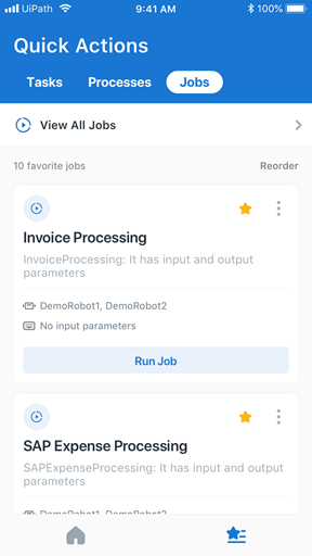

Quick Action Page
The Quick Action page enables you to quickly run recommended or favorite jobs.
Click the FavoriteQuickActionButtonFavoriteQuickActionButton icon at the bottom-right of the navigation bar to access this page. All the jobs you've marked as favorites are displayed on the Quick Action > Jobs tab.
If you haven’t added jobs to favorites while in the Job Detail or Jobs pages, the Quick Action page displays a list of recommended jobs for you to choose from and mark as favorite.
To favorite a recommended job, follow these steps:
  1. In the Quick Action > Jobs tab, click the Add to Favorite button under the desired job. The Edit Job page is displayed.
  1. In the Edit Job page, enter a custom name that is easy to remember. You can enter up to 25 alphanumeric characters.
  2. (Optionally) Edit the job's fields as you wish. Note that you can't change the job's process.
  3. Click Add to Favorites. The Quick Action > Jobs tab is displayed again, with the job marked as favorite with a FavoriteStarFilledFavoriteStarFilled icon next to it, and its custom name is saved. Also, the button changes to Run Job, enabling you to run the job with just a click.

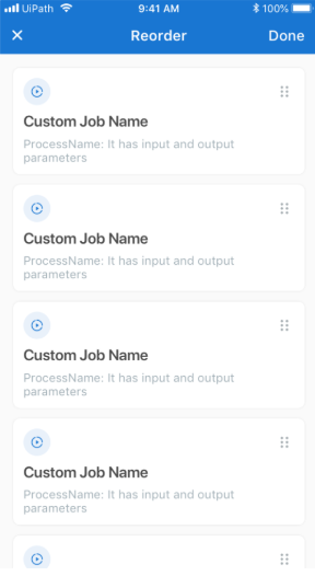

Reordering Favorite Jobs
It's a good idea to keep your favorites ordered from the most to the least frequently used. The app enables you to rearrange your current list of favorite jobs through drag & drop.
  1. In the Quick Action > Jobs tab, click Reorder in the top-right corner, to display the Reorder page. Here you can change the order of the jobs displayed on the Quick Actions page.
  2. Press and hold down a job. The color of the selected job becomes lighter, indicating that it can be moved.
  3. Drag the selected job up or down.
  4. Release the job when it reaches the desired place in your favorites.
Running Favorite Jobs
  1. In the Quick Action > Jobs tab, click Run Process corresponding to any of the favorite jobs. The Start Job page is launched on top of Quick Action, with the corresponding job pre-selected.
  1. Click Start Job to actually run the job you selected.
