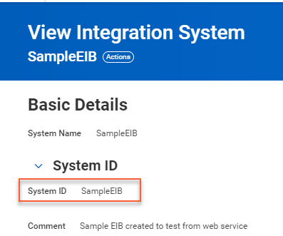

IntegrationSystemID
The name of the integration EIB that you want to launch.

Notes
Enter your value as it's shown under the System ID section of the EIB integration details page (see example below).

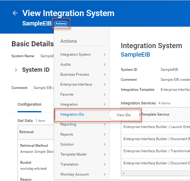

To get the WorkdayID value:
Go to the View Integration System page in your Workday tenant.
Select the EIB that you want to launch.
Click the Actions button and select Integration IDs from the menu.
