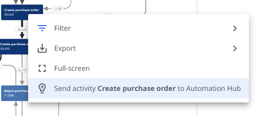

The Send to Automation Hub option is also available from the context menu of an Activity. See the illustration below.
526
