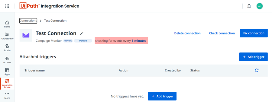

Polling interval
When you create a new connection and set up an event trigger on that connection, the polling interval is set by default to 5 minutes.
You can customize this interval using the Adjustable Polling Interval feature, which allows you to choose the interval on which event triggers check for new object events.
重要
You can have only one polling interval per connection, even though you can have several triggers set up per connection. Changing the polling interval affects all the associated triggers on a connection.
Polling runs on the connection at the selected interval. Once data has been retrieved, all active triggers for that connection are applied to the data set. If a poll is running when you change the interval, the service waits for the existing poll to finish, then starts another one.
Changing your polling interval
You can change your polling interval from the Automation Cloud – Integration Service page, either from a specific connector’s page or from the Connections tab.
- In Automation Cloud, access Integration Service.
- Go to the Connectors page and select a connector.
- In the connector’s page, select a connection to open the Connection Details page.
- Click on the interval found under the connection name, as follows. The polling interval is displayed only for connections with added triggers.
Alternatively, you can configure your polling interval from the Connections tab:
- Go to the Connections tab.
- Select a specific connection to open the Connection Details page.
- Click on the interval found under the connection name.
- The Update polling interval window is displayed.
- You can choose one of the available options or set up a Custom interval, in minutes or hours. The polling interval must be more than 1 minute and not longer than 24 hours or 1440 minutes.
The following error message warns you if you enter an incorrect value: The polling interval must be a natural number from 1 to 1440 minutes or 24 hrs.
- Click Update Interval.
