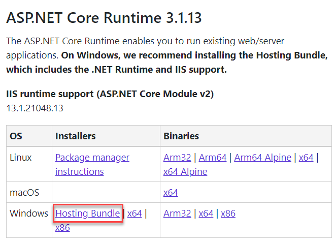

  • ASP.Net Core IIS Module - minimum version 3.1.x, available here as part of the Hosting Bundle. To download it, make sure you click Hosting Bundle, as shown in the following image.
662662
注:
Only the Core module is required, and can be installed without any runtimes by using the OPT_NO_RUNTIME=1 parameter from the command line.
