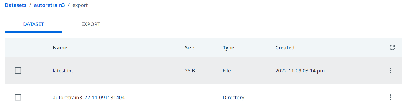

When you set the schedule for export, the imported data from the fine-tune folder is exported to the export folder under auto-export time_stamp.
To be more specific, the Scheduled Export imports the data which exists in the fine-tune folder created in Step 1, and then it exports the full dataset, including the previously existing data and the newly imported Validation Station data, into the export folder. So with each scheduled export, the exported dataset gets larger and larger.
The file latest.txt is updated or created if this is the first scheduled export. Here you can see the name of the latest export made by Document Manager. Schema export, however, does not update latest.txt. This file is used by the auto-retraining pipeline in AI Center to determine which is the latest export so it can always train on the latest data, so you should never remove or modify it, otherwise, your auto-retraining pipelines will fail.
