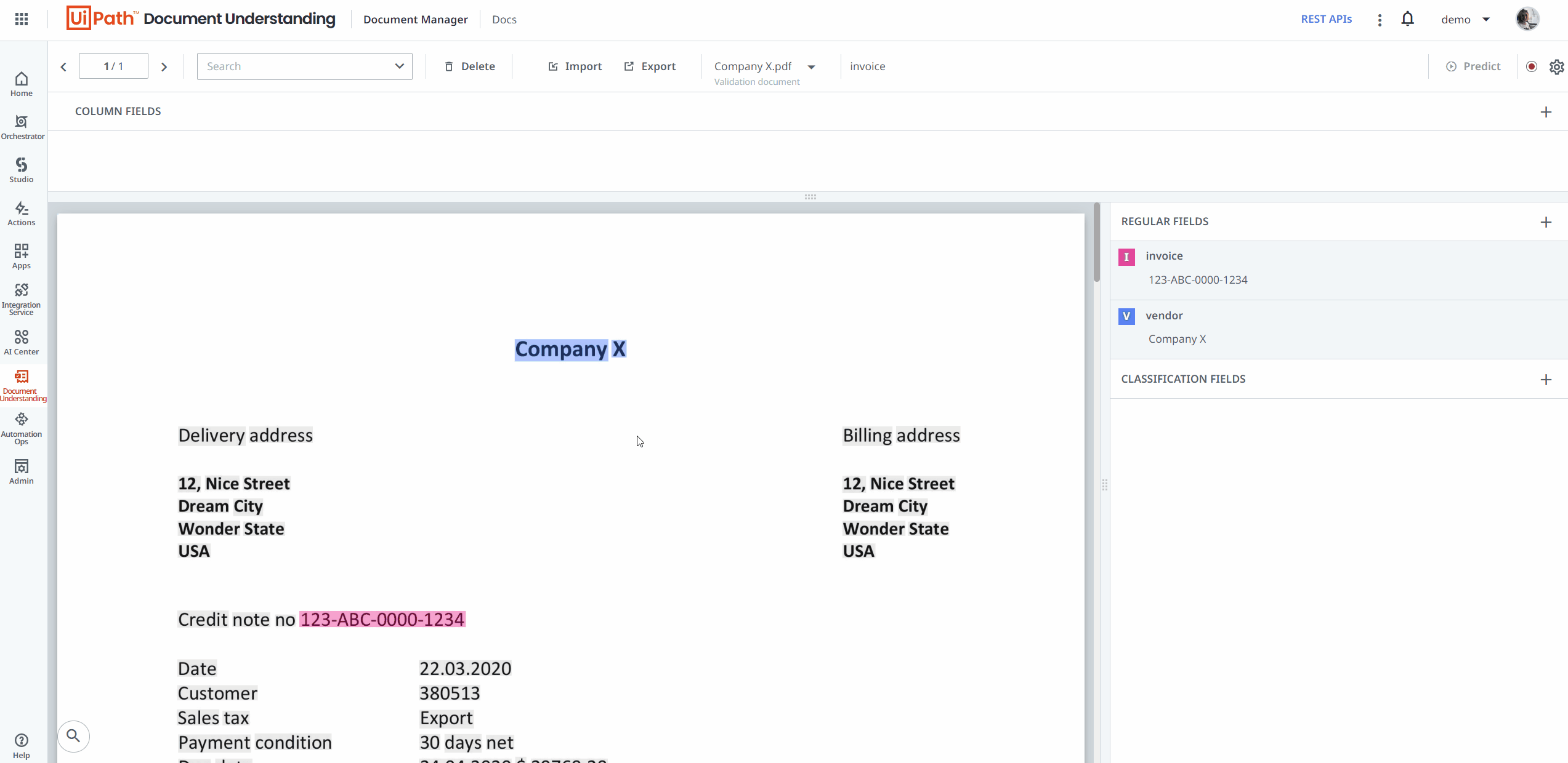

Label a field
Select an individual text box by clicking it.
To select multiple words, click the first word and then Ctrl/Shift+click the rest of the desired words or select an entire area by dragging the mouse (the rubber banding) over it.
To unselect certain text boxes from your selection, while Ctrl/Shift is pressed, click or rubber band the unwanted text boxes again.
When your selection is accurate, tap the shortcut key to label the field.
