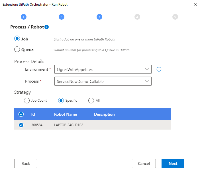

The Process / Robot selection page allows you to specify the robotic process in Orchestrator that the extension will call. This can be either a Job or a Queue, and you can choose additional options such as a specific robot or queue priority. The options that you will see will be dependent on the type of process you select.
Once this screen is completed, the Next button will take you to the Data Mapping screen.
Completed dialog for a specific job:

Common Properties
Process Selection
Attributes
Details
Type
radio
Required
Yes
Default value
Job
Allowed values
Job, Queue
Notes
Selecting and option will cause the page to display only those additional properties necessary to configure a process/robot of this type.
Job Properties
Environment
The environment to use.
Attributes
Details
Type
dropdown list
Required
Yes, if your process type is a Job.
Default value
Empty
Allowed values
The list of environments returned by your connection.
Notes
Selected an environment will cause the (Process) dropdown list to reload.
Process
The process to use.
Attributes
Details
Type
dropdown list
Required
Default value
Empty
Allowed values
The list of processes in the selected (Environment)
Notes
N/A
Strategy
The job strategy to use.
Attributes
Details
Type
radio
Required
Default value
Specific
Allowed values
Job Count, Specific, All
Notes
The choice of Strategy will determine which other parameters will be displayed for that strategy type.
Inputs
The number of jobs to run.
Attributes
Details
Type
Int32
Required
Yes, if you are using the Jobs Count strategy.
Default value
Empty
Allowed values
An Int32 value.
Notes
N/A
Specific Robot
The specific robot or robots that you want to use.
Attributes
Details
Type
selection
Required
Yes, if you are using the Specific strategy.
Default value
Empty
Allowed values
One or more specific robot selections.
Notes
N/A
Queue Parameters
Queue Name
The name of the queue to use.
Attributes
Details
Type
dropdown list
Required
Yes, if you are using the Queue process type.
Default value
Empty
Allowed values
A valid selection from the dropdown list.
Notes
Selecting and option will cause the page to display only those additional properties necessary to configure a connection of this type.
Priority
The priority level to use when starting a job.
Attributes
Details
Type
radio
Required
Default value
Normal
Allowed values
Low, Normal, High
Notes
N/A
