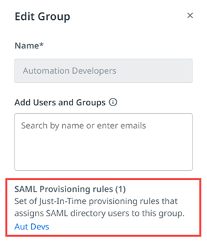

Auto-provisioned accounts are not shown
If your organization is integrated with a third-party identity provider and if auto-provisioning was set up, directory accounts or directory groups that are being auto-provisioned may not be shown in the Add Users and Groups text box, even though they benefit from this group's resources.
如果是这样,文本框下方会显示一条消息:
