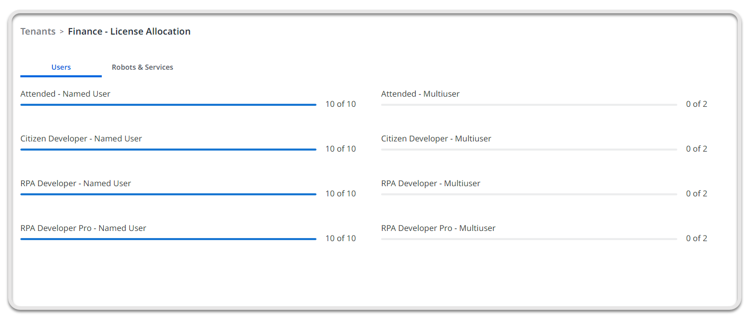

Checking License Allocation per Tenant
  1. Click Admin > Tenants. The Tenants page is displayed.
  2. On the Tenants page, click License Allocation next to the tenant you want to check license metrics for. The License Allocation page is displayed, showing the number of allocated licenses for each license type.

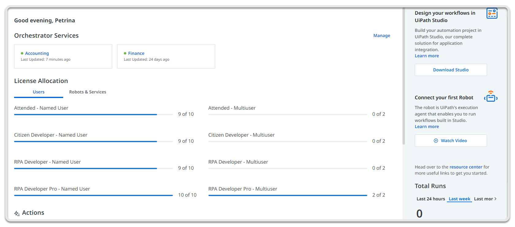

Checking License Allocation in the Organization
A. Click Home. The homepage is displayed. Check the License Allocation section to see the number of allocated licenses out of the total number of purchased licenses in your organization. Switch between the Users and Robots & Services tabs to change the displayed license type.

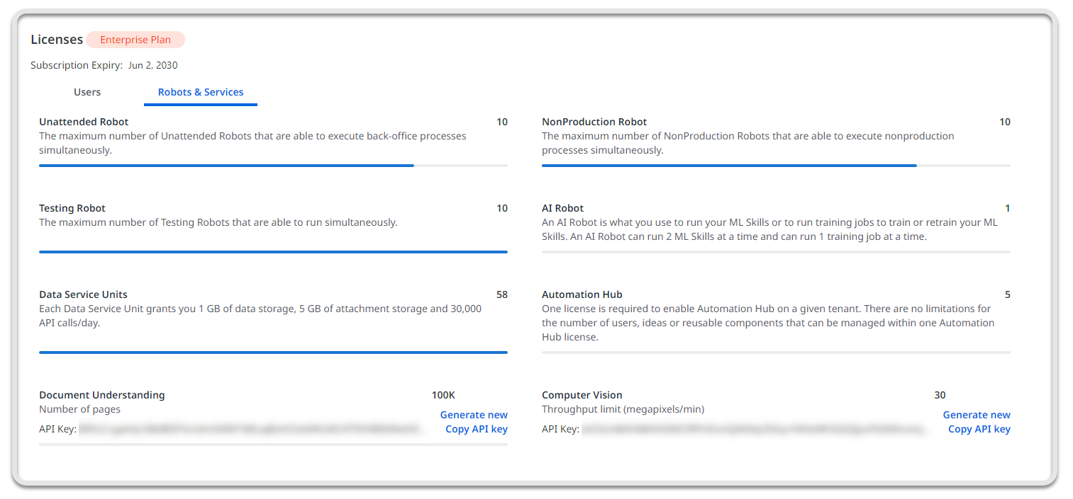

B. Alternatively, click Admin > Licenses. The Licenses page is displayed, showing the number of all purchased licenses in your organization. Switch between the Users and Robots & Services tabs to change the displayed license type. Hover over the progress bar to see the number of allocated licenses out of the total number of purchased licenses in your organization.
If a license type is not displayed, it means there are 0 licenses of that type purchased for your organization.
