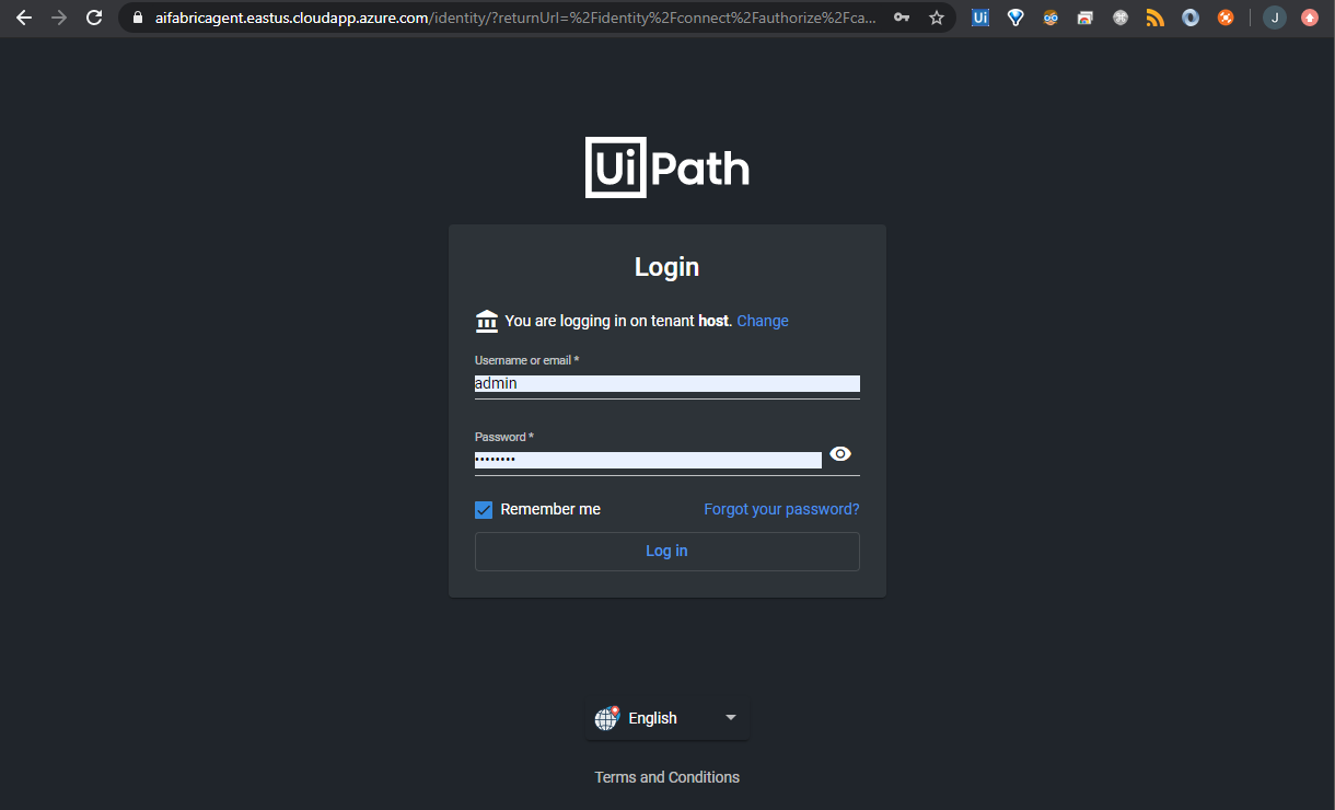

  • Navigate to <linux-machine-ip or domain-name>:31390/ai-app, click on the three-dot menu on the top right, and click on Log in
  • Log-in with the host tenant admin credentials. Make sure you log in to the host tenant, the default will be default.

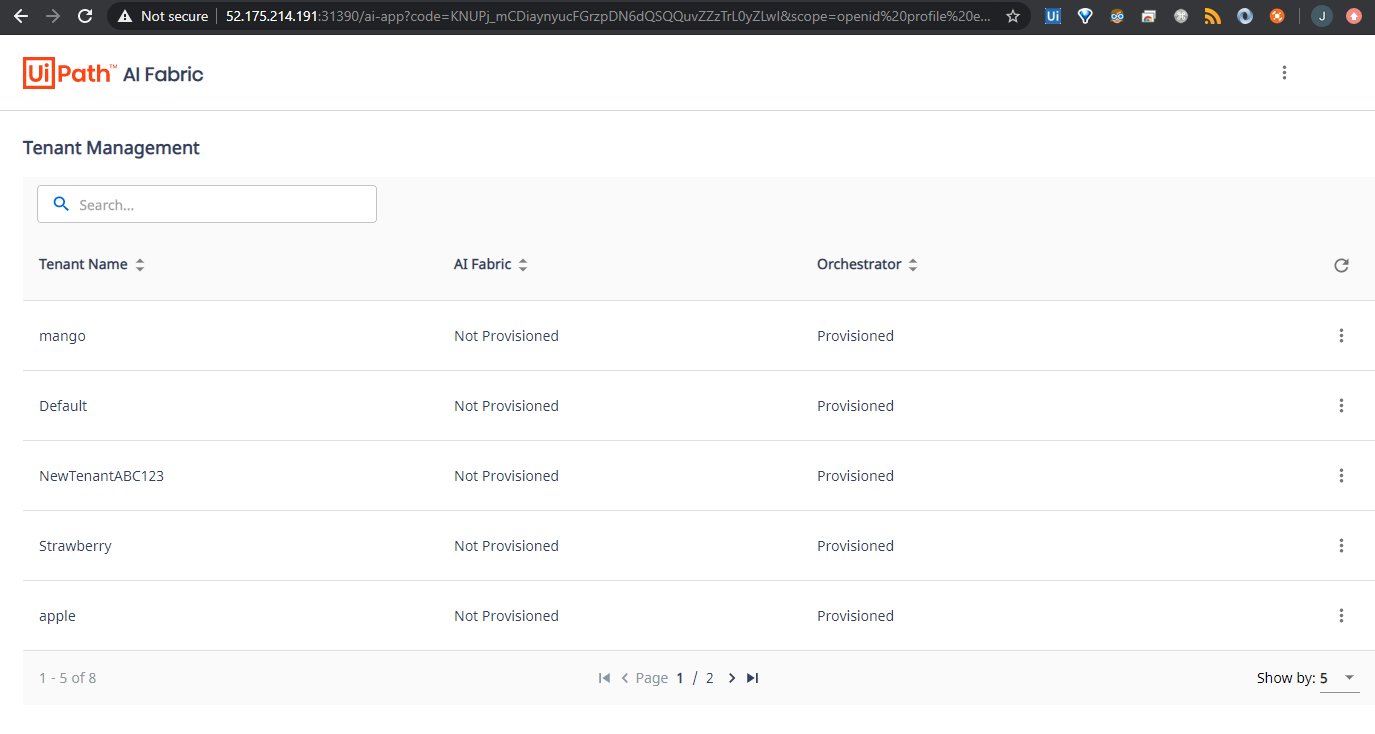

  • Once logged in, you will see the list of all Orchestrator tenants associated with your account. The first column is whether that tenant is also provisioned in AI Center . Since this is the first time you are logging in, all tenants will show Not Provisioned under AI Center . Click on the 3-dot menu for the tenant you would like to provision, and click Provision. After a few seconds, refreshing will show that tenant as provisioned

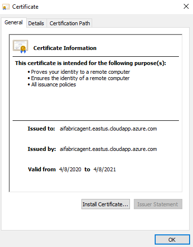

Navigate to <machine-ip or domain-name>:31390/ai-app. This step involves adding the application certificate to your trusted certificate store.
  • In Google Chome, click the padlock icon in the address bar (this will be an exclamation icon when you repeat the process for port 31443). Some steps may not appear depending on your Chrome version.
  • Click the Show connection details arrow
  • Click the More Information button
  • Click the View Certificate or Certificate button
  • Click the Details tab in the top navigation
  • Click the Copy to File button
  • Follow the Certificate Export Wizard and export the certificate and save it as base64-encoded to some path you can easily reach later.
  • Double-click that certificate and click Install Certificate
  • Set the store location of the certificate to your Local Machine, and place the certificate into the Trusted Root Certificate Authorities folder
