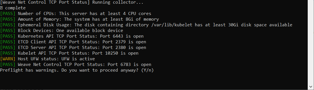

Few preflight checks will be run before the script actually start. These checks will verify that your machine has the correct configuration they are not foolproof but should be a good indicator. In particular, if you are using Ubuntu, you may see the following line:
[WARN] Host UFW status: UFW is active
UFW is a firewall which is installed by default on recent Ubuntu OS, if you are using the default config there shouldn't be any issue if you are using specific rules this can interfere with Kubernetes behavior. If this message is displayed, you can continue by pressing Y.

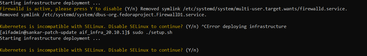

In a similar way, firewall and SELinux are not compatible with Kubernetes. If you receive a messages as in the picture below, proceed by pressing Y.
