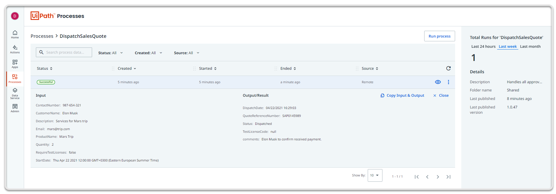

The Details page opens, displaying an entry for every process run, with the following details:
- Status.
- Creation date.
- Start date.
- End date.
- Source (for processes).
- Exception (for queues).
To view more specific details, select View process data for a specific entry. This expands the Input and Output/Result data of the corresponding process, to help you track the changes made between entries.
