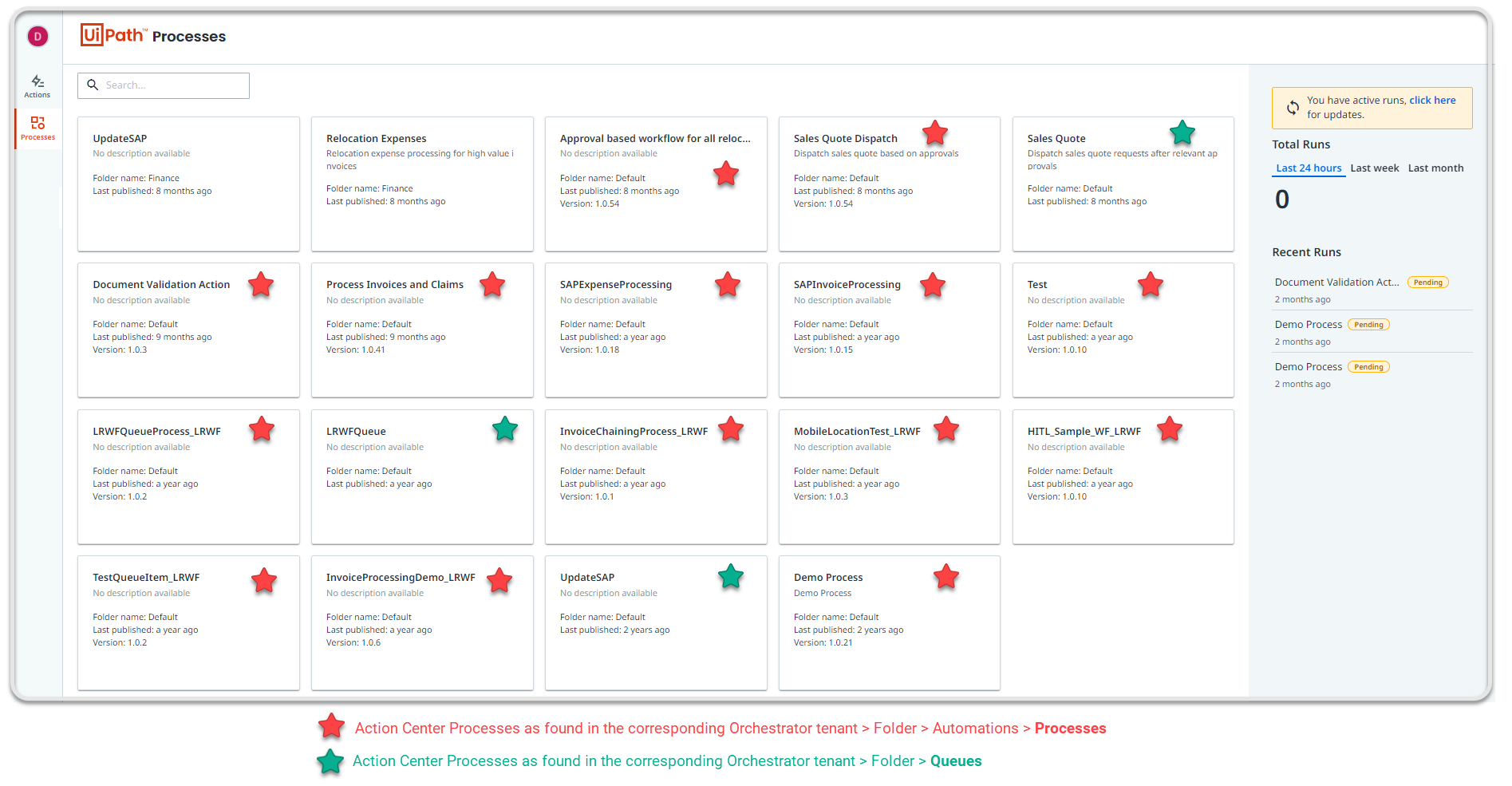

Accessing processes
To access processes, navigate to the Processes tab from the left-hand menu in Automation CloudTM .
Displaying processes
A card is displayed for every queue or unattended process found in the Orchestrator folders that you have access to, containing the following details:
- Process name.
- Description.
- Recipient folder name.
- Latest publishing date and time .
- Published package version (for processes only).
Processes cards.

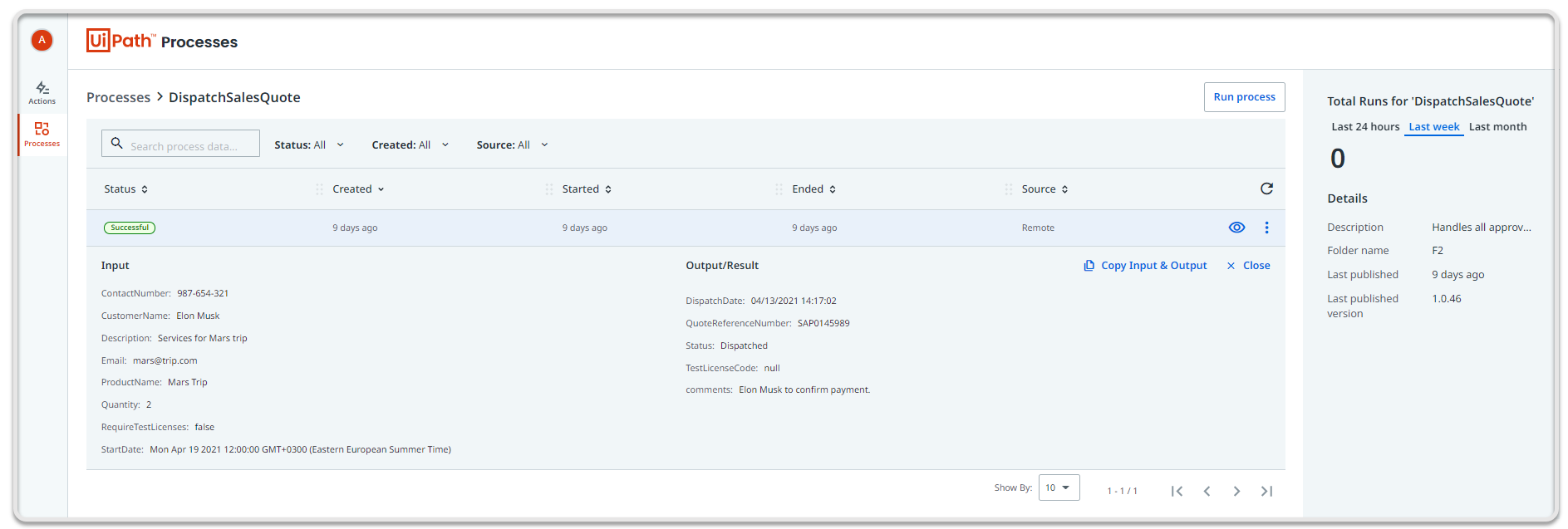

Viewing details
To view a specific process detail, hover over the process card and click View details .
The Details page opens, displaying an entry for every process run, with the following details:
- Status.
- Creation date.
- Start date.
- End date.
- Source (for processes).
- Exception (for queues).
To view more specific details, select View process data for a specific entry. This expands the Input and Output/Result data of the corresponding process, to help you track the changes made between entries.
To restart a process, kill it, or remove it from the entries list, click More options .
The Details page of a process.
